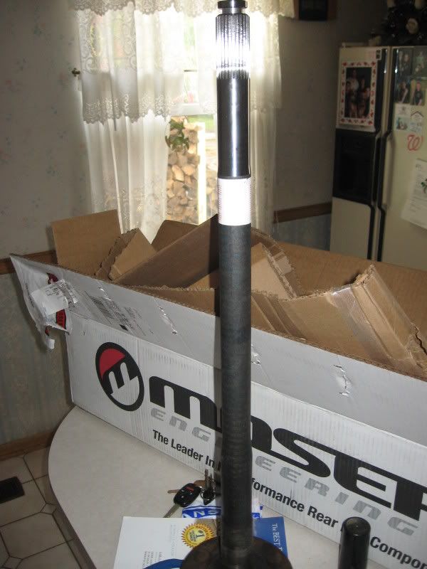

but i only sent out 1 axle to Moser and fliped my other axle to the other side. i cant remember the exact measurements but its around 3"

yea they just shorten ur stock shaft...i think it was $65 all said and done
here is mine when i got it back

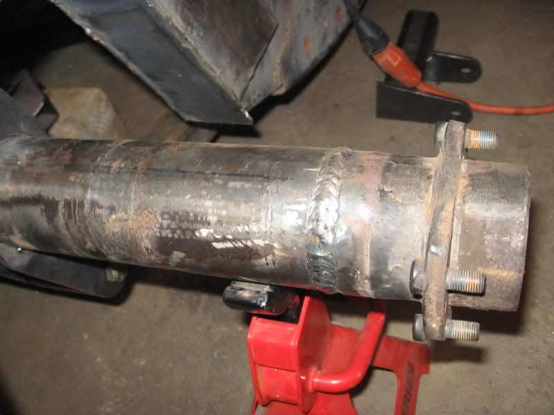

i dropped off my axle housing to these guys. they were the closest to my house Fast Lane Fabrications Race Cars, Pro Street Cars, Street Cars, Street Rods
i payed $275 and i set up the gears my self
