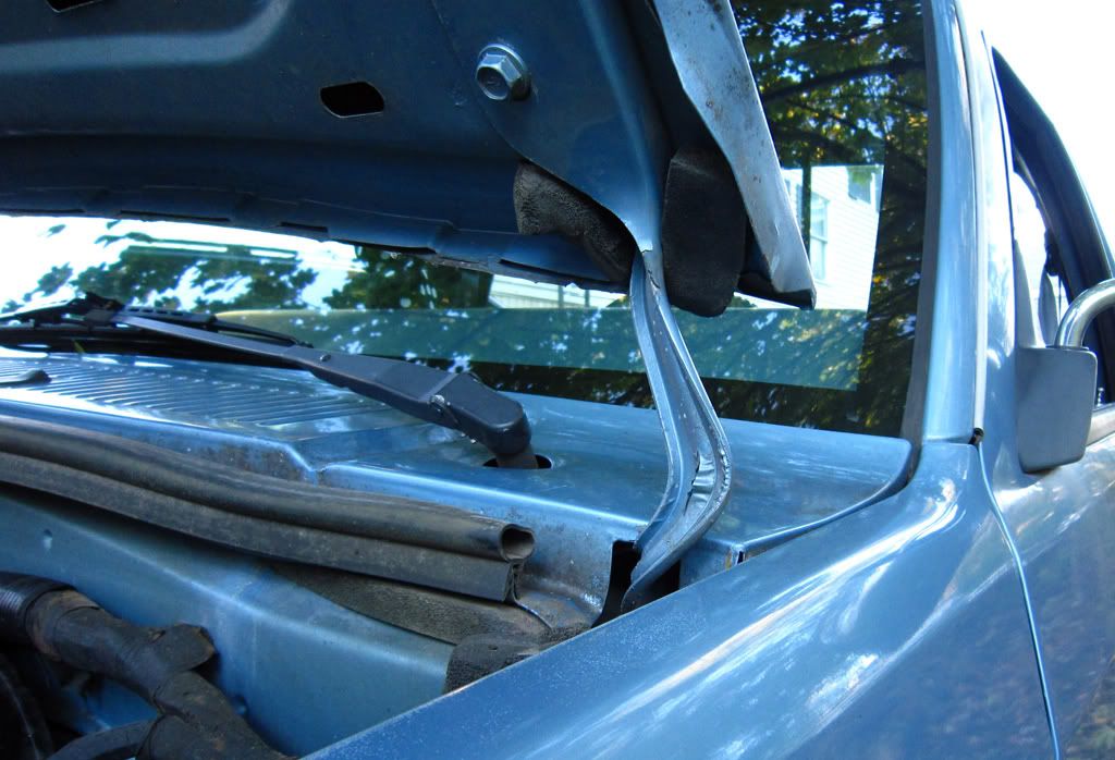

I replaced the front core support today (between fenders and around radiator). Ran out of daylight so I left the hood latch for tomorrow.... well I just went out for a coffee and doughnut going about 35mph and the hood flew up, over my wipers smashed onto my windshield, friggan blocked 110% of my vision almost got in an accident. Bent both my hood hinge arms sideways and back, now the hood sits a few inches up on all 4 sides!
Also if you notice in the circle it dented this panel in... I will be replacing that too I guess:

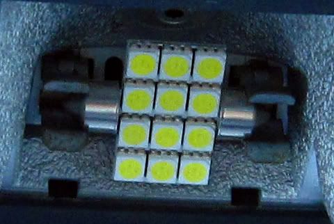

I replaced my incandescent dome light bulb with a new LED bulb. It's more of a panel, with 12 LEDs (much more even coverage). It's bright as fuk too!
There is a dramatic color difference as well, you can see here between the LED and stock vanity/dash light. The LEDs have more of a natural white sunlight color.
As you can see the before and after:
