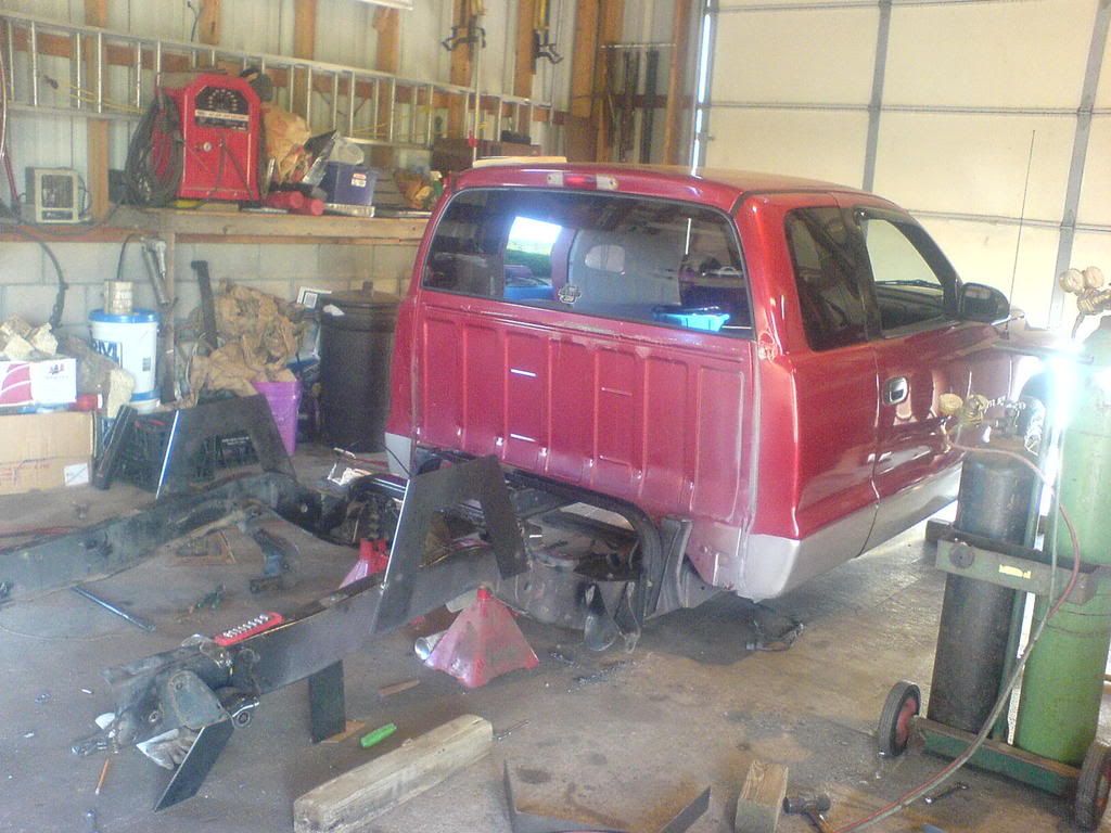

Alright I have the whole rear of my dak apart and still cant decide what kind of setup to run. This is my first build so I want something fairly straight forward. If i run a parallel can I add a pair of canti. arms later if im not happy with the ride of the bags over the axle, and use bags on bars?
heres a pic so far poor quality cuz i took it with my phone

It is usually better to go ahead and do it right the first time, Its a pain to go back and redo the whole setup. The bag over axel does not ride that bad imo, but it is not any more difficult to get a nice triangulated 4-link with bags on bars and run that. Just look around at Suicidedoors.com

yea u can that happen to me chack out my pic here . i have a parallel 4 link the bag over tha axle is good not to much work but if u going to body drop it later i think u dont get anuft lift so that when i went with a canti arm later gou a hole bunsh of lift but it up to u

I think that is what im gonna go with this is my first truck bulid and dont want to get in over my head
