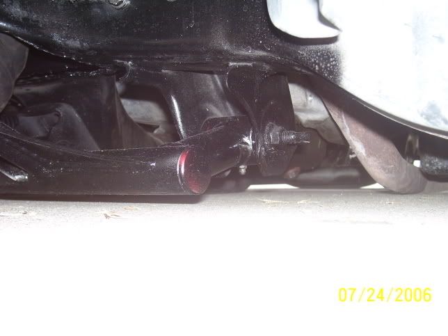

now do i have to cut out my front fenderwells, or can i get away with not cutting them out?
well i just bagged my front end today, and i will need to cut mine out, cause i cant even scrape Y pipe. i have 235/60 on my stock 16" rims up front. And i know with my setup, i can easily go another 2- 3" if i had a rim that tucked and no fender well.
