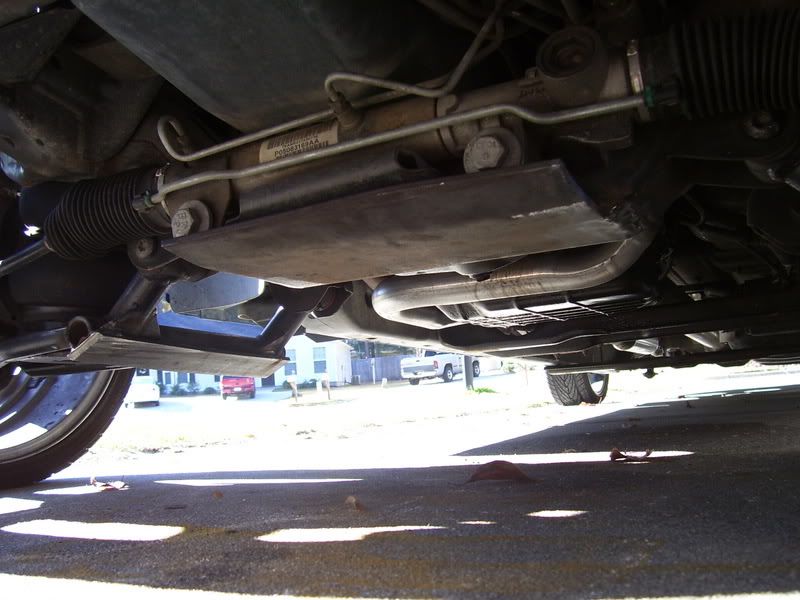

Usually drag the front crossmember down so it will lay flat. Then plate it with a quarter inch peicse of flat stock.

becarful dragging the crossmember. I drug mine a little to much and alost drug off my oil drain plug. Defiently plate it if you are going to be dragging it.
Discussion Starter · #11 ·
whats involved in plating the xmember????? Is it just welding metal to it and dragging that instead of the xmember it self or am i missing something.
152 Posts
Yep that's about it. Your just adding metal to be drug off instead of dragging the frame/crossmember till it's super thin and start to damage other things.
