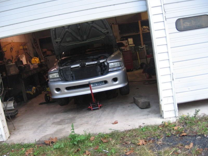

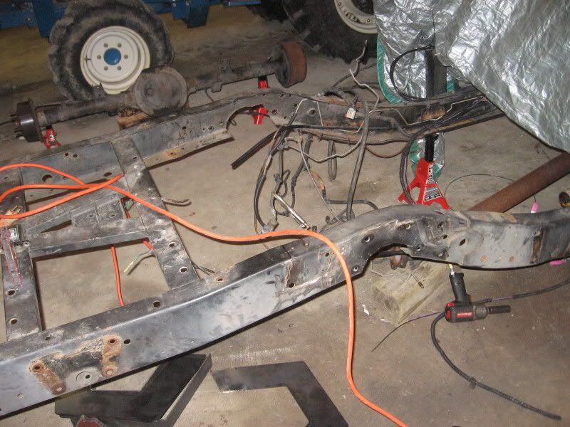

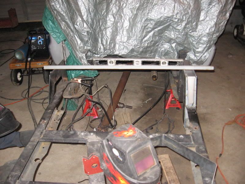

ive been working on my truck but i kept forgetting my carmera to take pics
im goin to bag the rear now, i got tired of being only bagged in the front

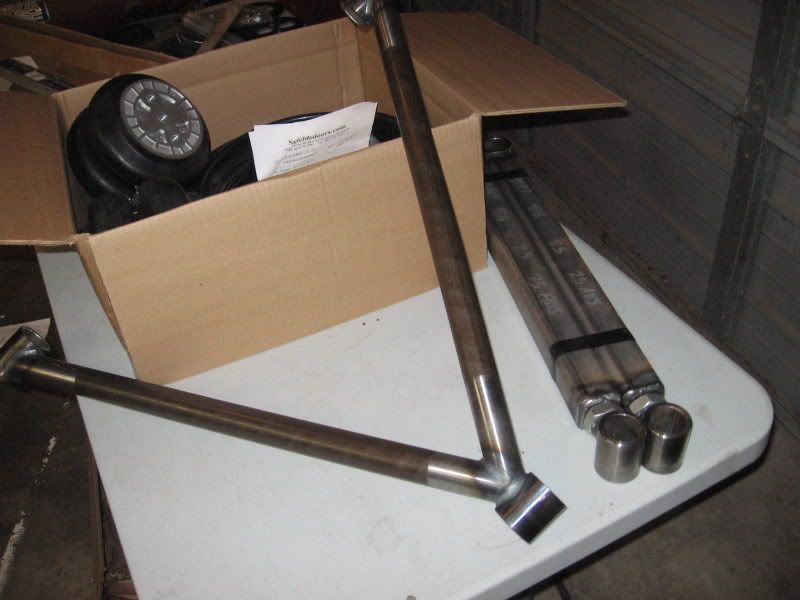

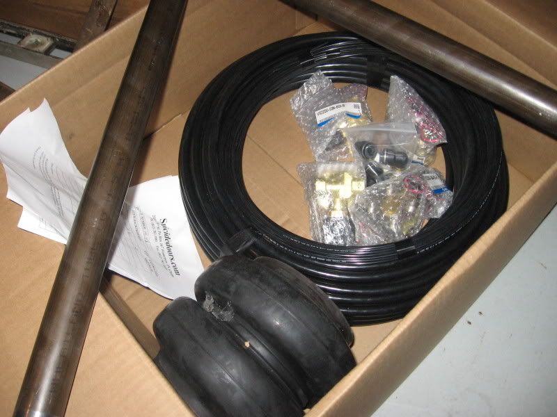

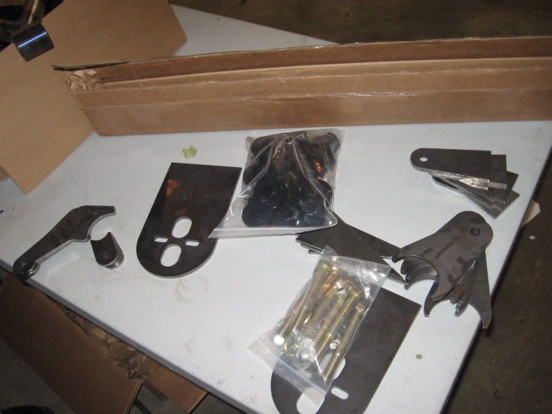

Parts i bought:
-SD super lift wisbone kit bars 25" wishbone 30" wide 25" lenght
-1/2 fill 3/8 dump smc valves
-8" notch
-shock bar
- RE8 slams
-fuel cell from speedwaymotors.com
-also shorting the axle

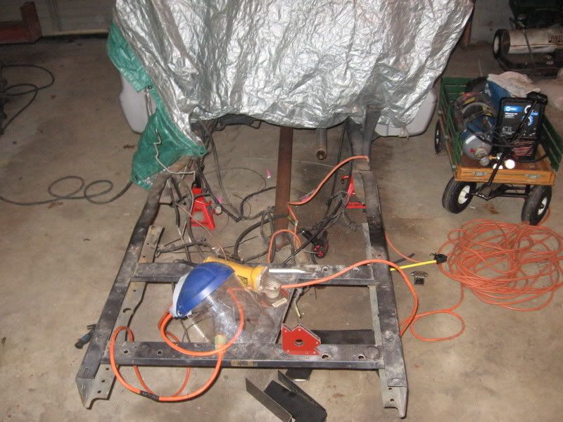

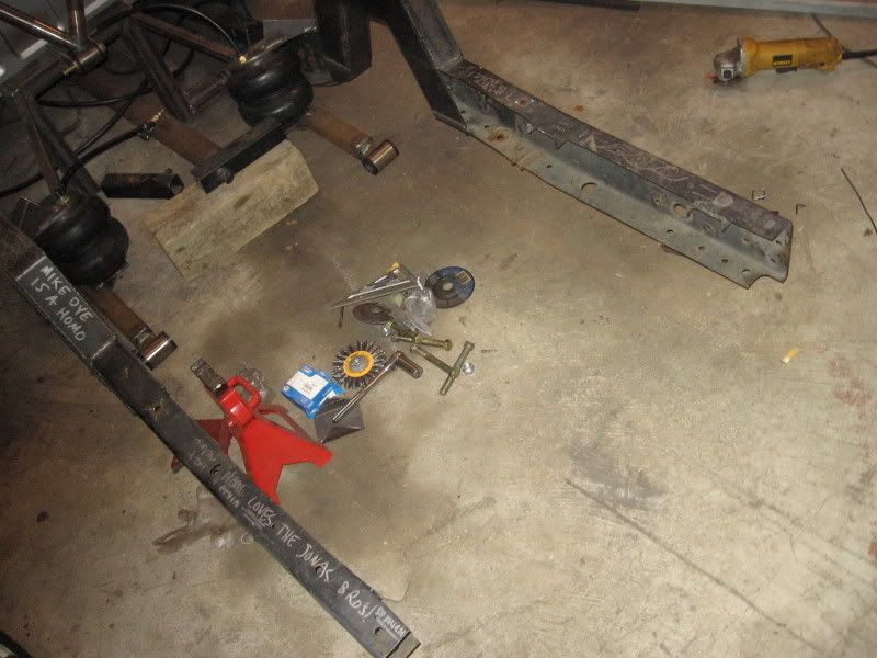

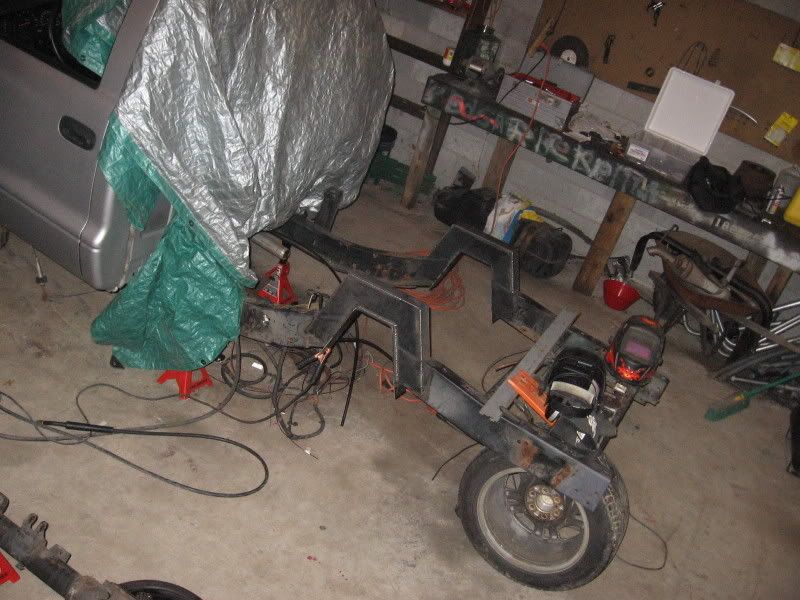

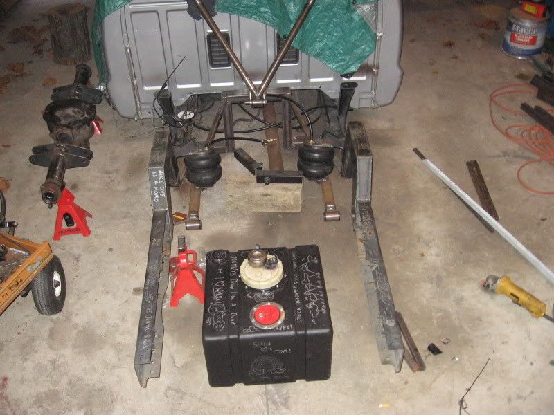

Stripped down

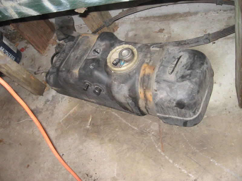

gas tank
parts

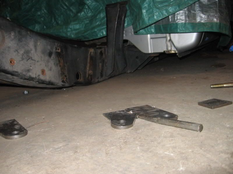

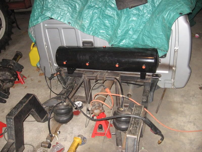

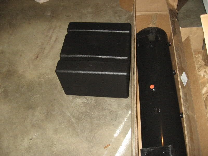

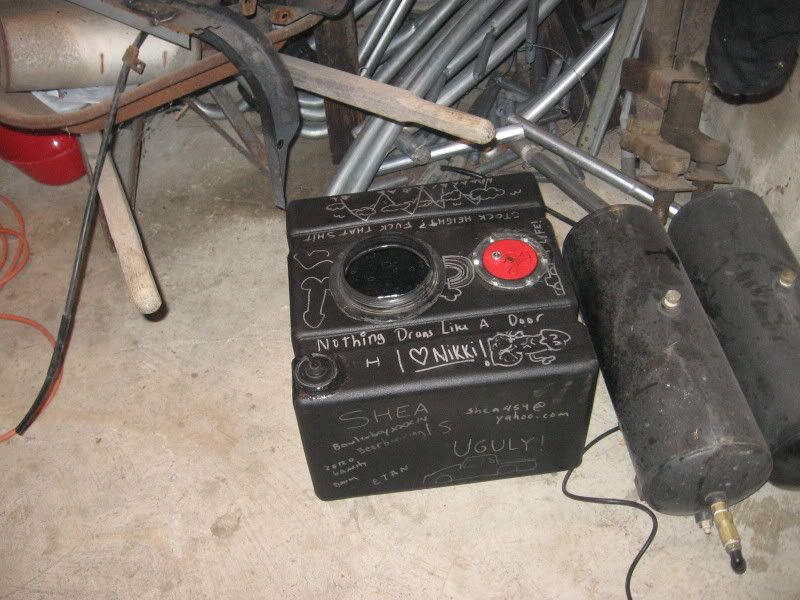

more parts came in, gas tank and the air tank

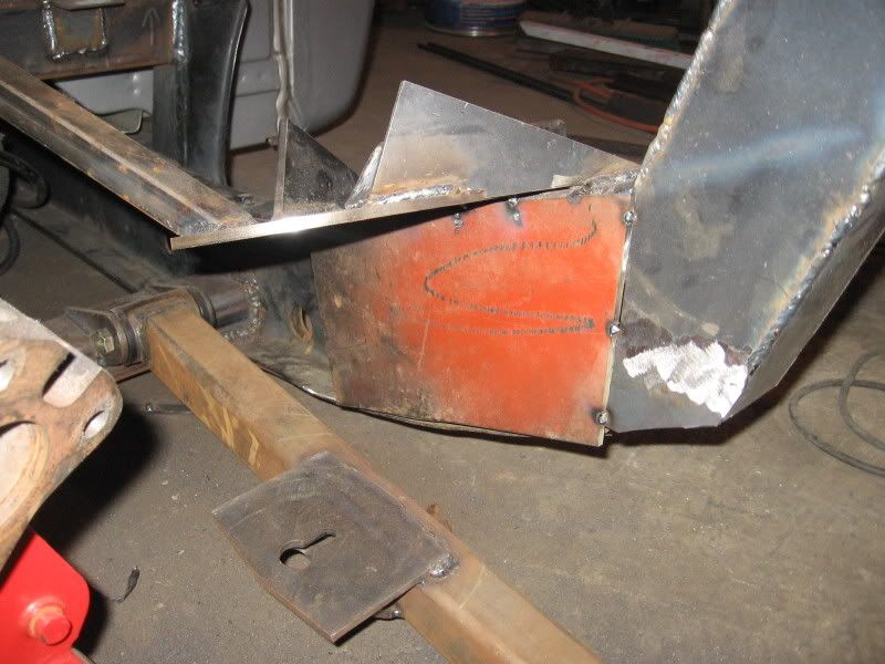

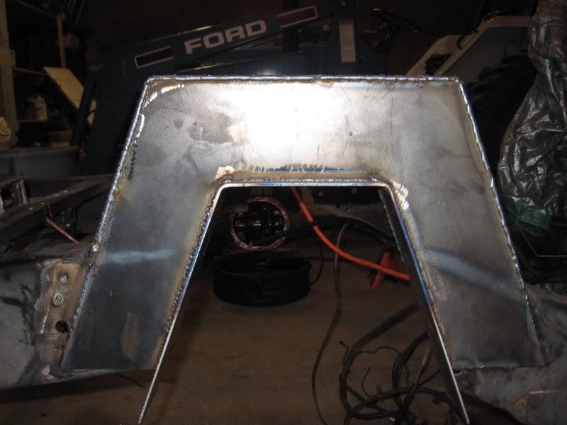

notch
nuthin but the best lol

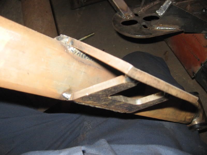

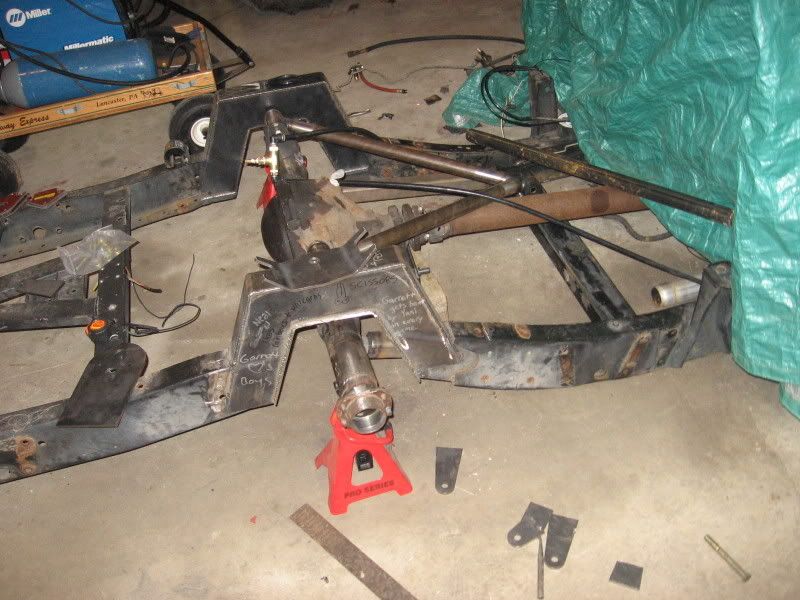

axle narrowed for 250$ at fastlanefabrications.com in jefferson,md

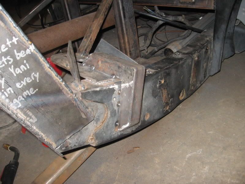

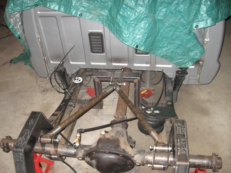

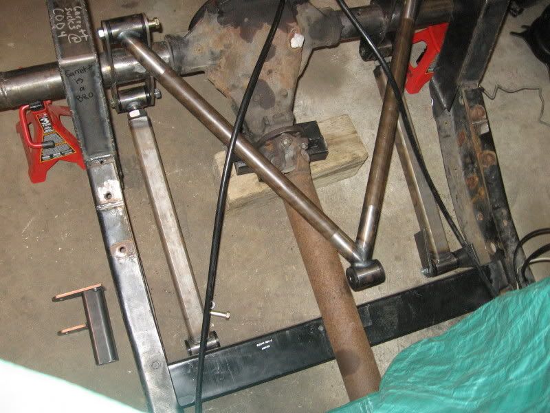

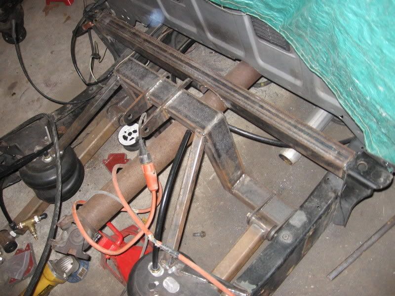

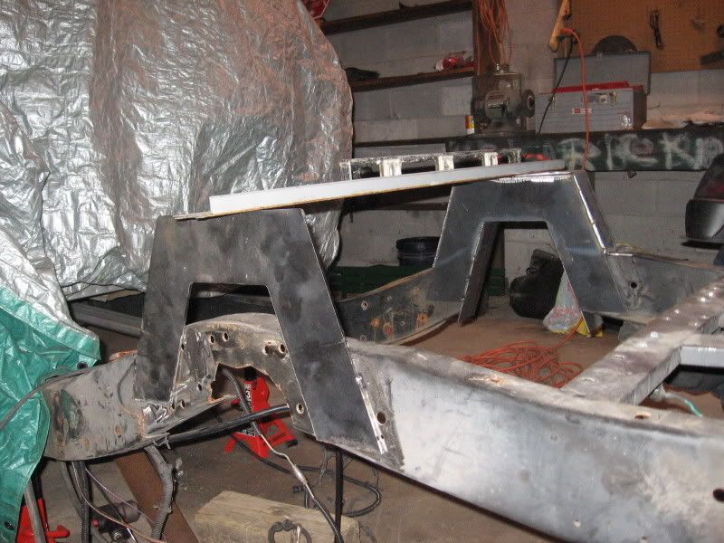

bars tacked on

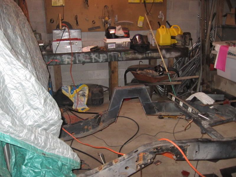

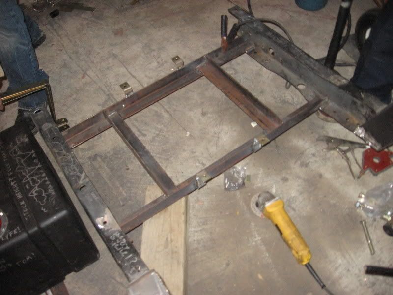

layin frame

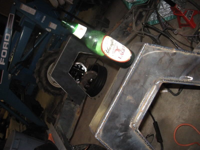

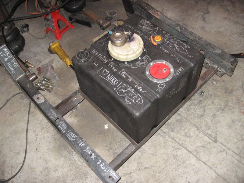

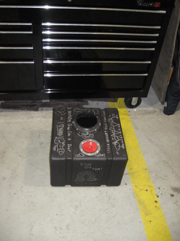

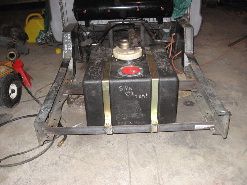

progress on the fuel cell...my friends got a hold of some sharpies

nice thanks for the help on the ideas on how to do mine is 8 inches going to be enough for frame to ground contact lol im jsut going to notch mine this week i hope if i can motivate my self
1,058 Posts
Discussion Starter #10
yea 8" notch is enough....but u could go with the 10" if you want too

nice, how much did that whole rear setup cost ya and where from? how big is thats fuel cell?

16 gal fuel cell- 85$
screw it ill make it 9. lol thats from where frame used to be right so bottom of frame to bottom of notch if that makes since i like your setup by the way the wish bone looks nice

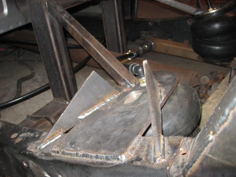

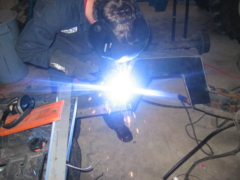

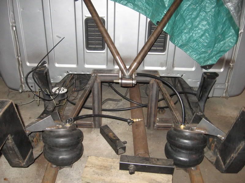

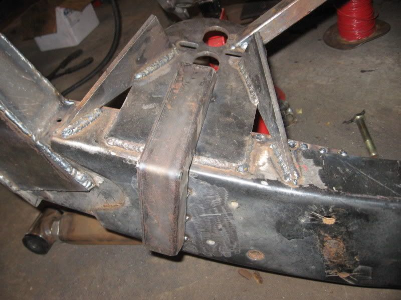

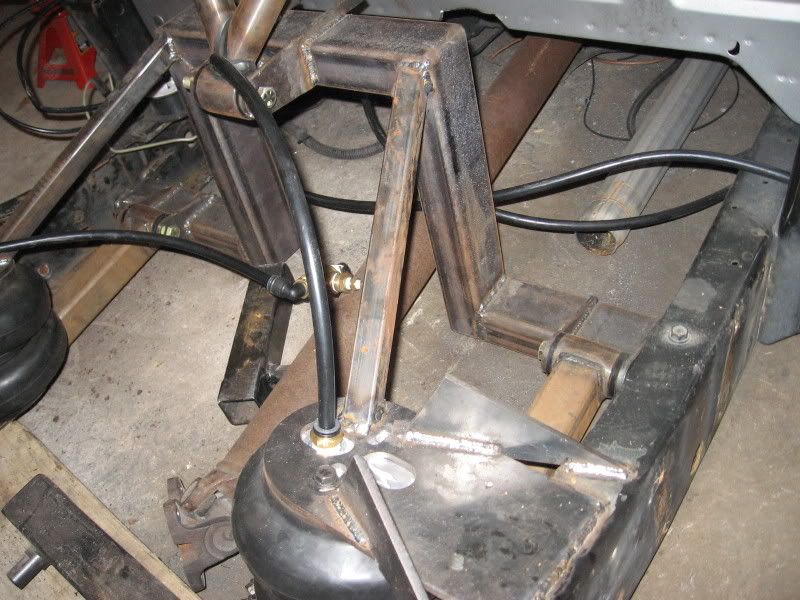

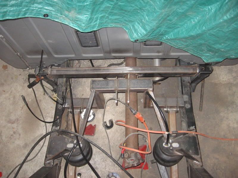

some more progress

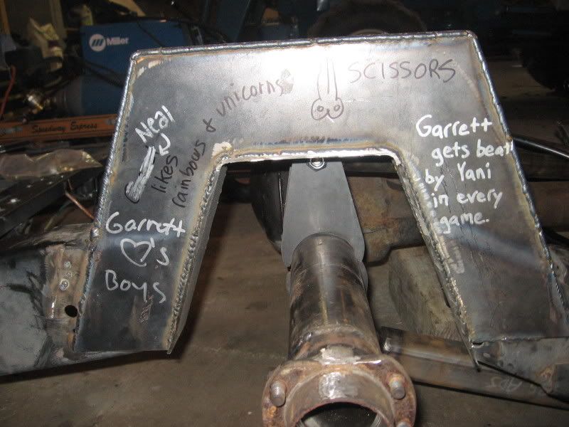

i finished my crossmember and my my bag mounts are almost done
1,058 Posts
Discussion Starter #19

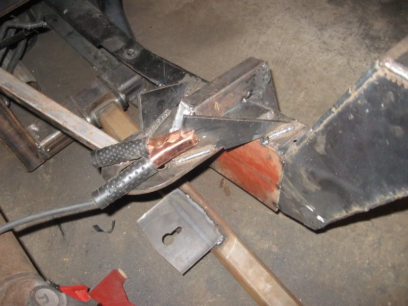

i finished my cell at work, by installing the fuel pump ring

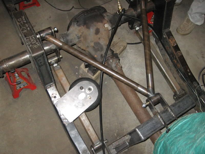

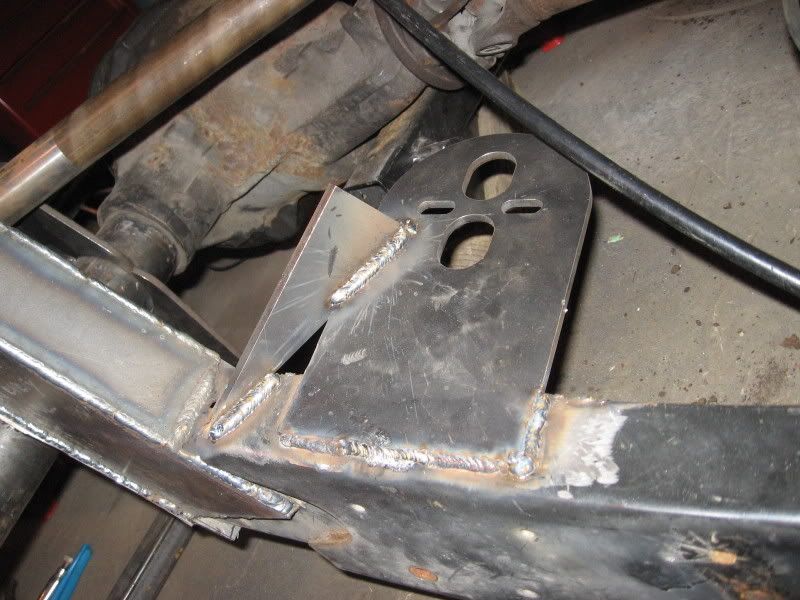

bag mounts done

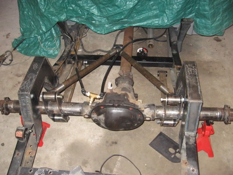

the axle is not in because i had to do some measurements.
