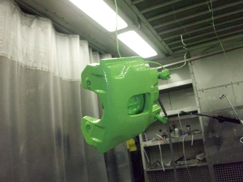

Thanks Man !! I used DTM (direct to metal) primer sealer, 10 minute flash off, color, 10 minute flash, clear. I painted the frame under the cab today too but I am going to wait until its bolted back up to take more pics

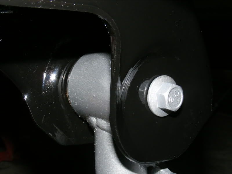

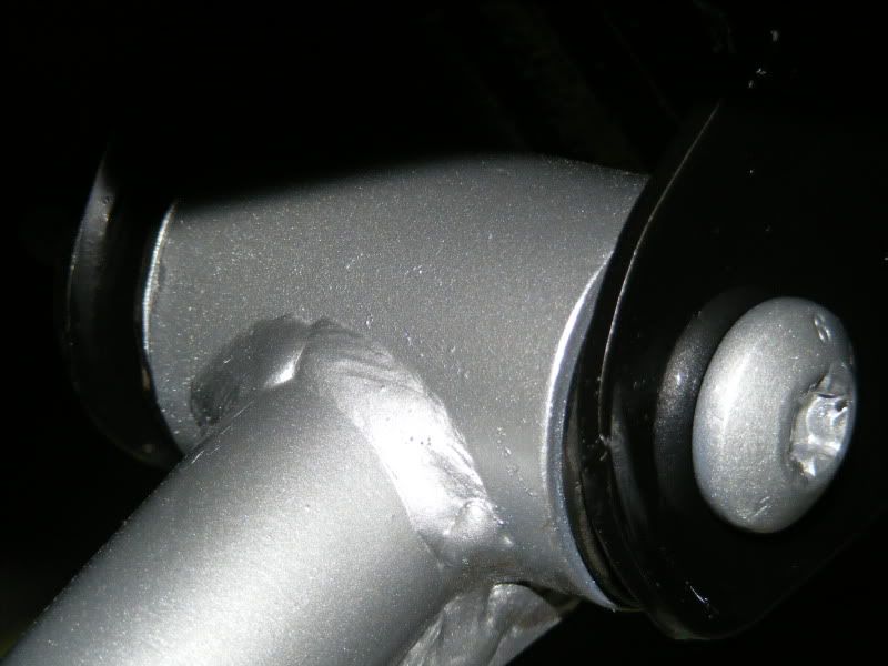

Some shots with the frame bolted back up. The POR-15 has some dirt in the final coat, i will be redoing one i get everything back together after i finish scratching it.

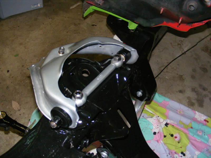

well after taking some time off to care for my wife & son, couple of teasers before this weekend

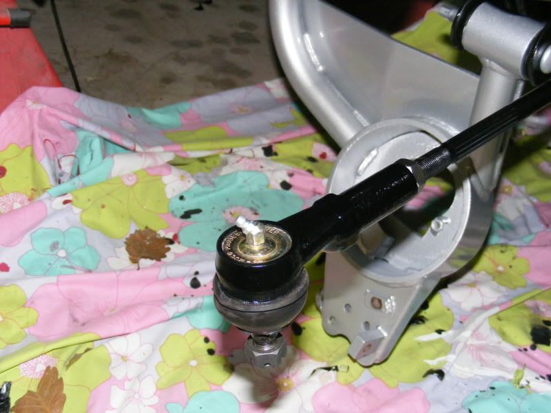

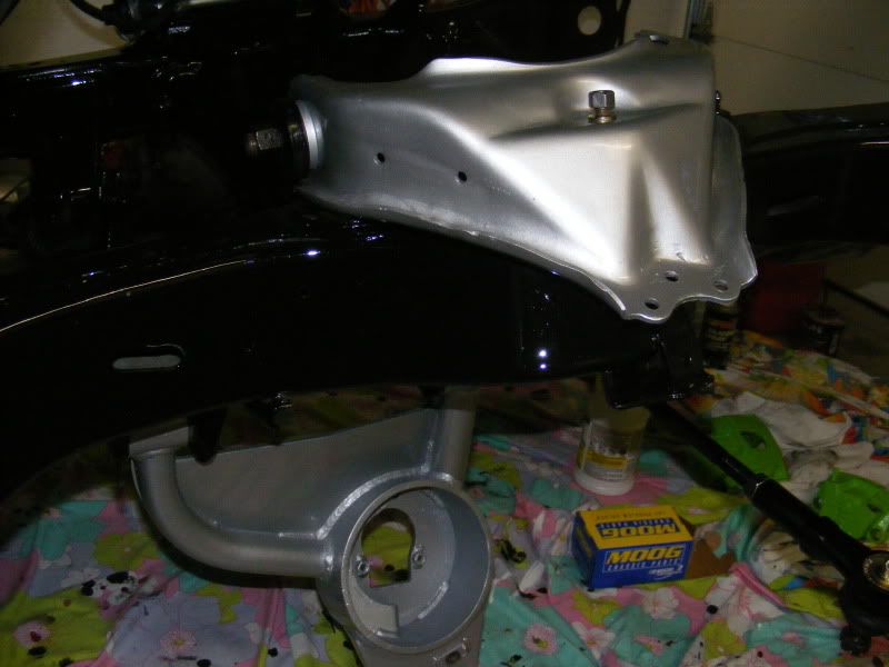

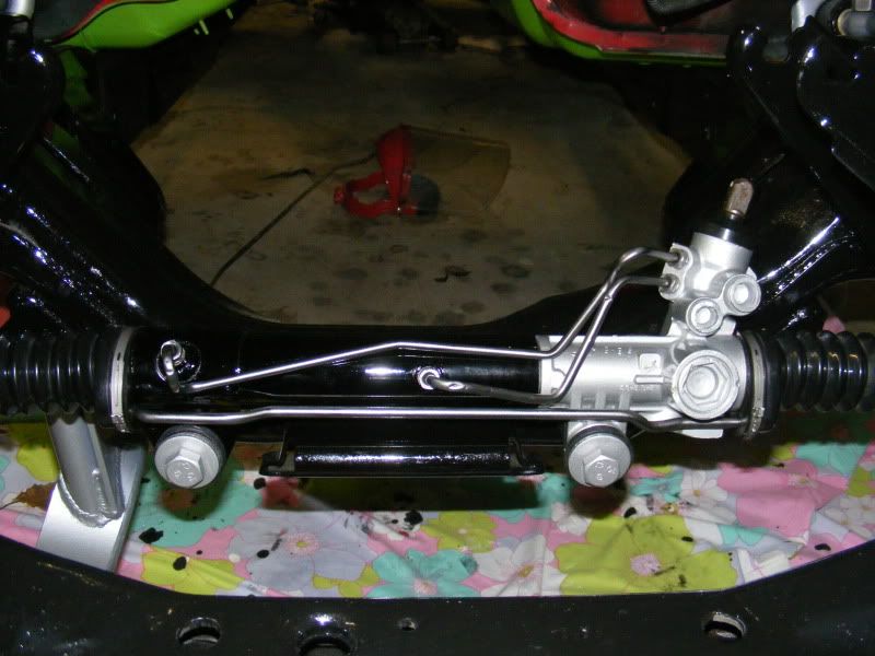

So I didnt have enough time to get everything done I wanted to with housework & my son but I was able to get the steering rack in and done as well as the arms set in place.
Mind the one line, its original & dented (thought it was 3/16 tube, its 1/4 & I ran out)
